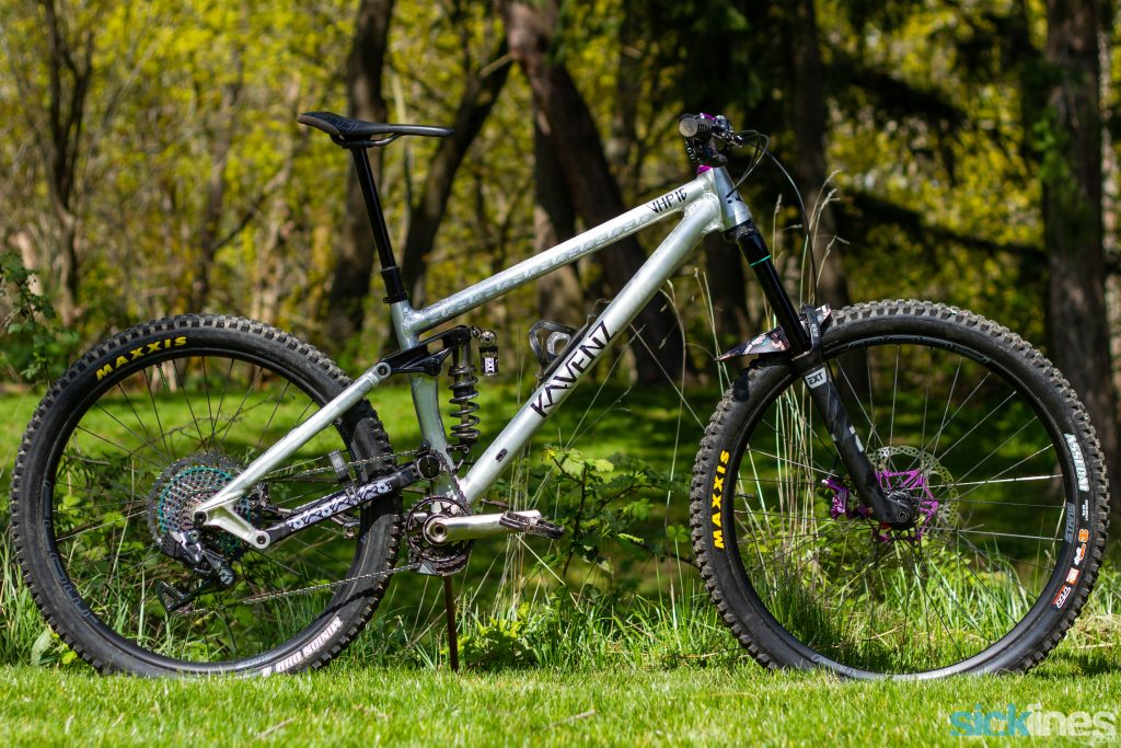

The Kavenz take on the high pivot design begins with a frame constructed of 7020 alloy resulting in a carbon-competitive weight of 3.28 kg in size medium. The suspension layout is a Horst-link configuration with a high main pivot and idler pulley. Rear travel is 160 mm and recommended fork travel is 160 to 180 mm. In a nod toward simplicity and easy maintenance, all bearings are S6902 Max. Rear axle width is standard boost 148 however the supplied rear brake adapter is for 203 mm rotors. It is possible to run smaller than 203 mm rotor but you’re limited to 185 mm, as there are clearance issues with 180’s. All cables route internally and the BB spec is the fan-favorite 73 mm threaded. A full sized water bottle easily fits within the front triangle provided you use a side-loader cage. Both of the builds in this review opted for raw finish which are truly raw with no clear coat or other finishing work except for black anodized chainstays. An extensive selection of powder coat and anodizing options are available for those that are interested in adding a little more flare to their build.
The VHP16 is available in both full 29’er and MX (mullet) configurations. There are six base sizes from which reach, seat tube, and head tube can be customized for 36 possible configurations. I started my review on a stock size large (480 reach, 450 seat tube, 110 head tube) set up mullet and later I built up a custom bike from scratch in nearly the same configuration except I opted for a 420 seat tube. Kavenz has chosen to stick with just one chainstay option across all sizes which measures at 419 mm at rest on the MX build or 429 mm on the 29’er build. The small difference in chainstay length between 28 and MX is a byproduct of the shock mount unique to each configuration in order to correct BB drop. Head angle is fixed at 64º based on a fork with a 581 mm a-to-c measurement. Because the frame employs a zs44/zs56 head tube, head angle customization is possible with angled headsets. The VHP16 gets away with a slightly relaxed 77.5º seat tube angle thanks to its very high anti-squat values. Overall, stock geometry is right in line with current trends with a nod towards balanced handling vs something like a Norco Range which is 36 mm longer in the equivalent size.

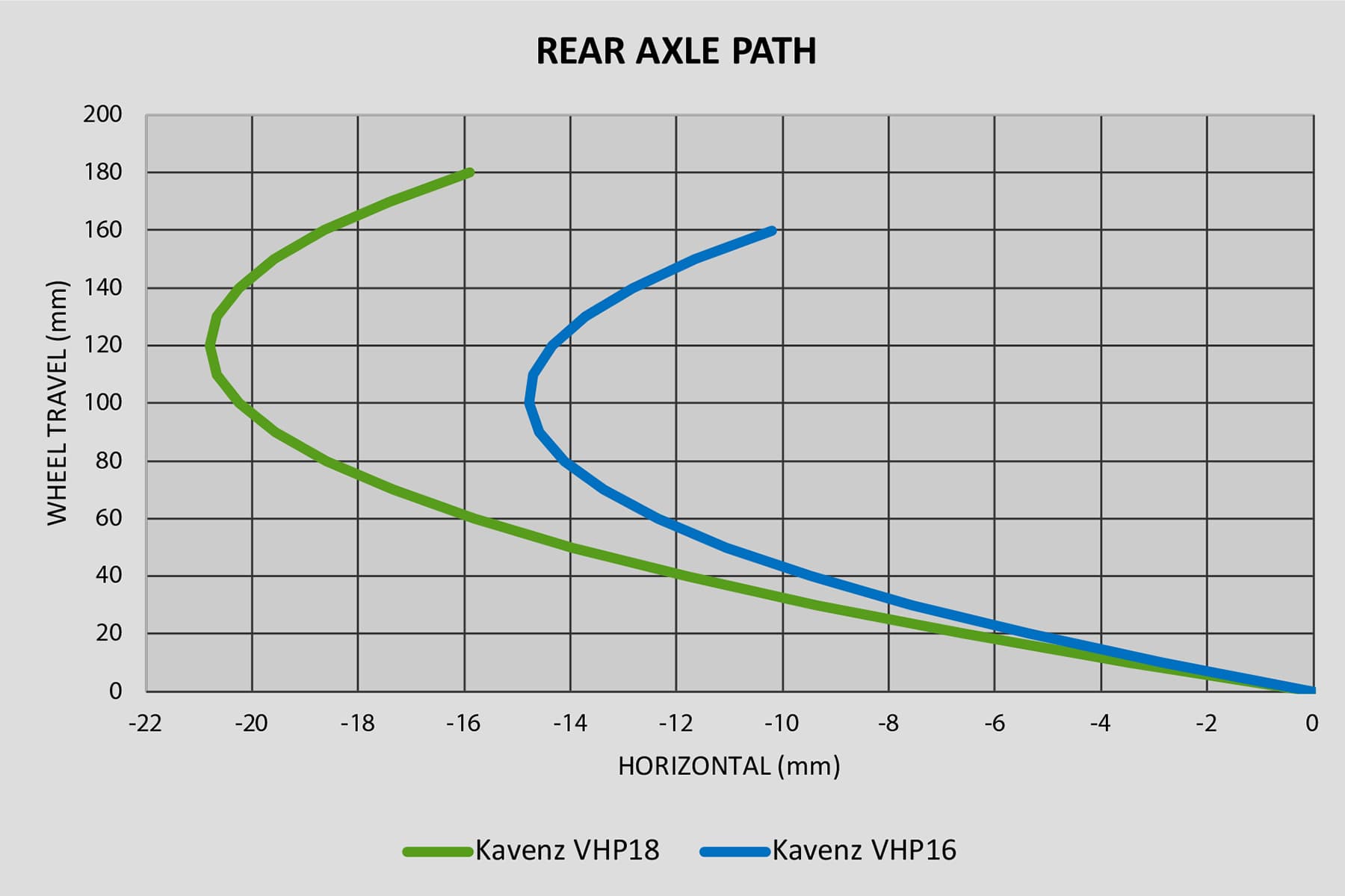

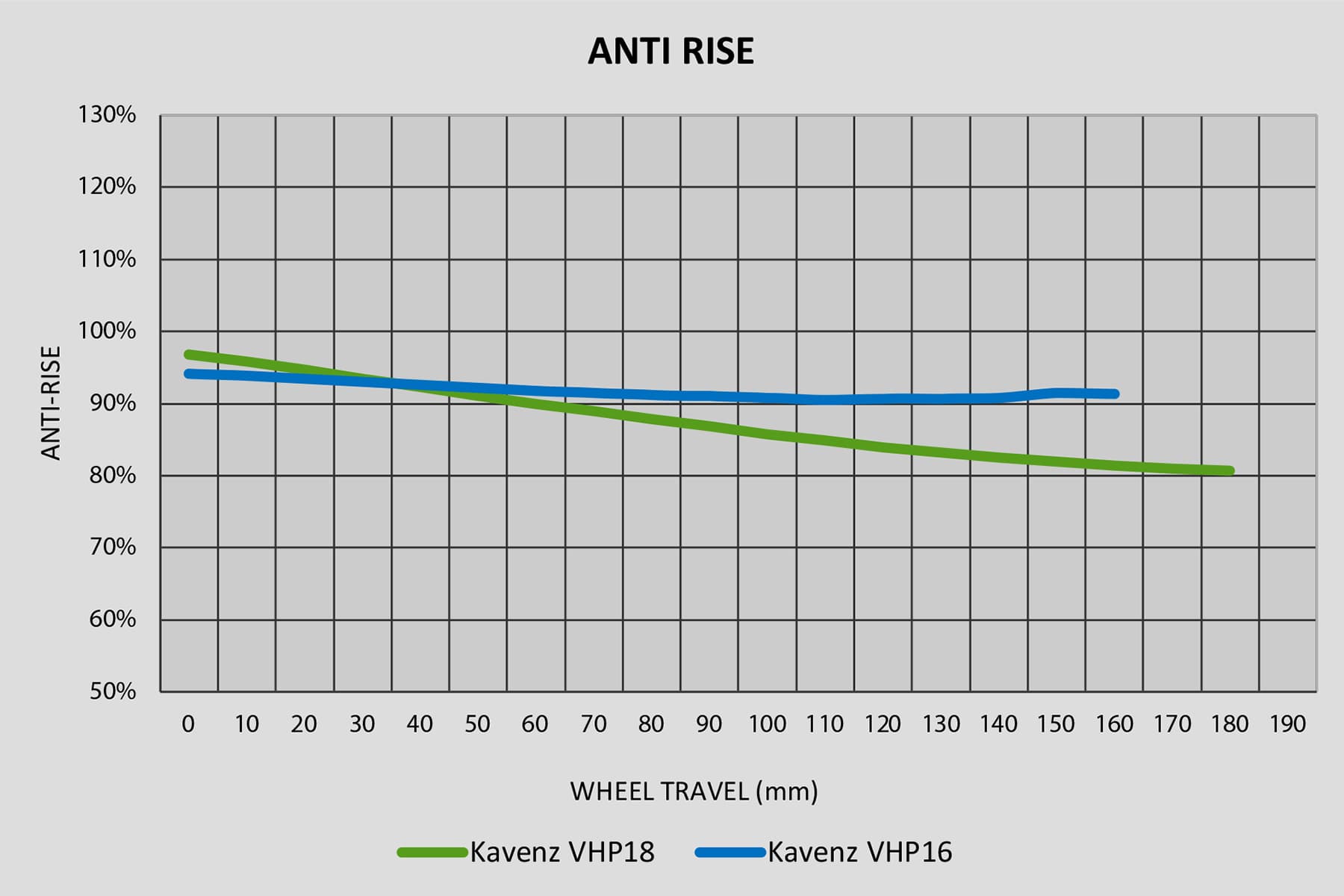

For those of you who love graphs and raw data… This stuff is interesting but keep in mind that there are limitations to how much you can derive from these charts. Otherwise there would be no need to actually ride the bike for the test, right? Still, the Kavenz VHP16 project is much to do with optimizing these values. If you’re interested in seeing the rest of the data, you can find it here.
Kavenz have achieved a consistent shape to their leverage ratio curve, resulting in 29.9% progression for plenty of bottom-out control without an abrupt change at the end of the stroke. This suggests the entirety of the 160 mm travel will be accessible under most conditions and that both coil and air shocks will work well (top right). Anti-squat values are high, consistent with a well optimized idler, indicating that the VHP16 will pedal efficiently. In fact, it should be a rocket under power.
When it comes to high pivot point bikes, there is a balance to be struck between rear axle path and the anti-rise values you’re after. In the case of the VHP16, Kavenz wanted to keep inputs as neutral as possible as so much enduro racing is done on blind courses. This is why when you look at the axle path (top right), it’s not a radical as it could be. This helps maintain balanced anti-rise (top left) and a consistent demeanor under braking.

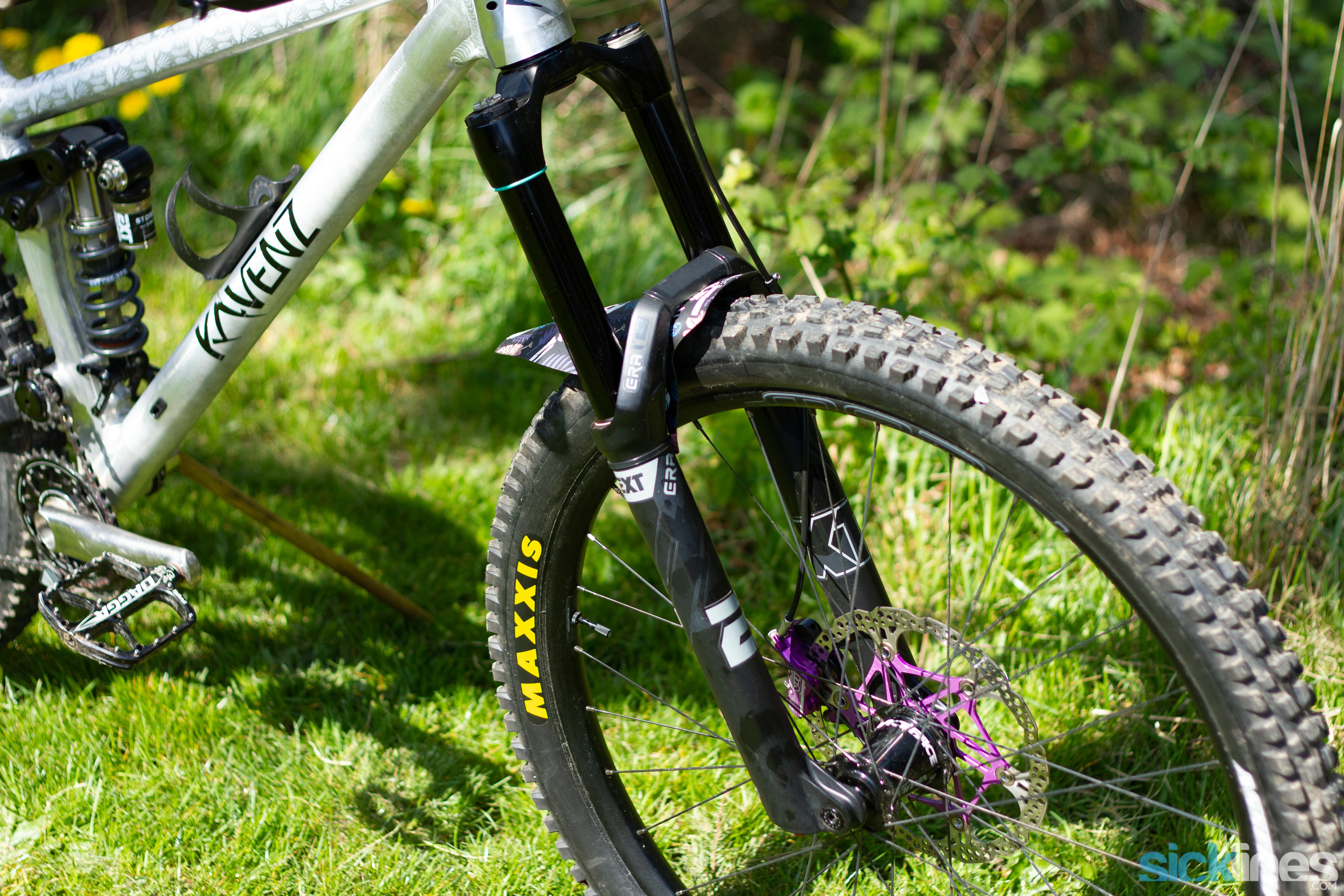

The original test bike that Kavenz sent over was set up with a Fox 36 at 170 mm. The 36 is fine for trail riding but it never really felt like it kept up the rear suspension. A 38 would have been a more suitable option. I opted for an EXT Era set to 170 mm which I had on hand from a previous build. The Era is as good as it gets in a single crown with the best mid-stroke support and the best small bump compliance in class. I’ve just taken delivery of an Era V2 which promises to take things to another level – stay tuned for a separate review and comparison. Rounding out the front end, a 2.5 Assegai in EXO+ Maxx Grip mounted to a 29″ Stan’s Flow MK4 laced 3-cross to a Race Face Vault hub with Sapim CX-Ray spokes and brass nips by yours truly. Out back there’s a matching wheel but in 27.5″ since this is a mullet setup. I bring this all to a stop as fast as traction will allow with Hope V4 brakes squeezing a 223 mm rotor up front and a 203 mm rotor in the rear.

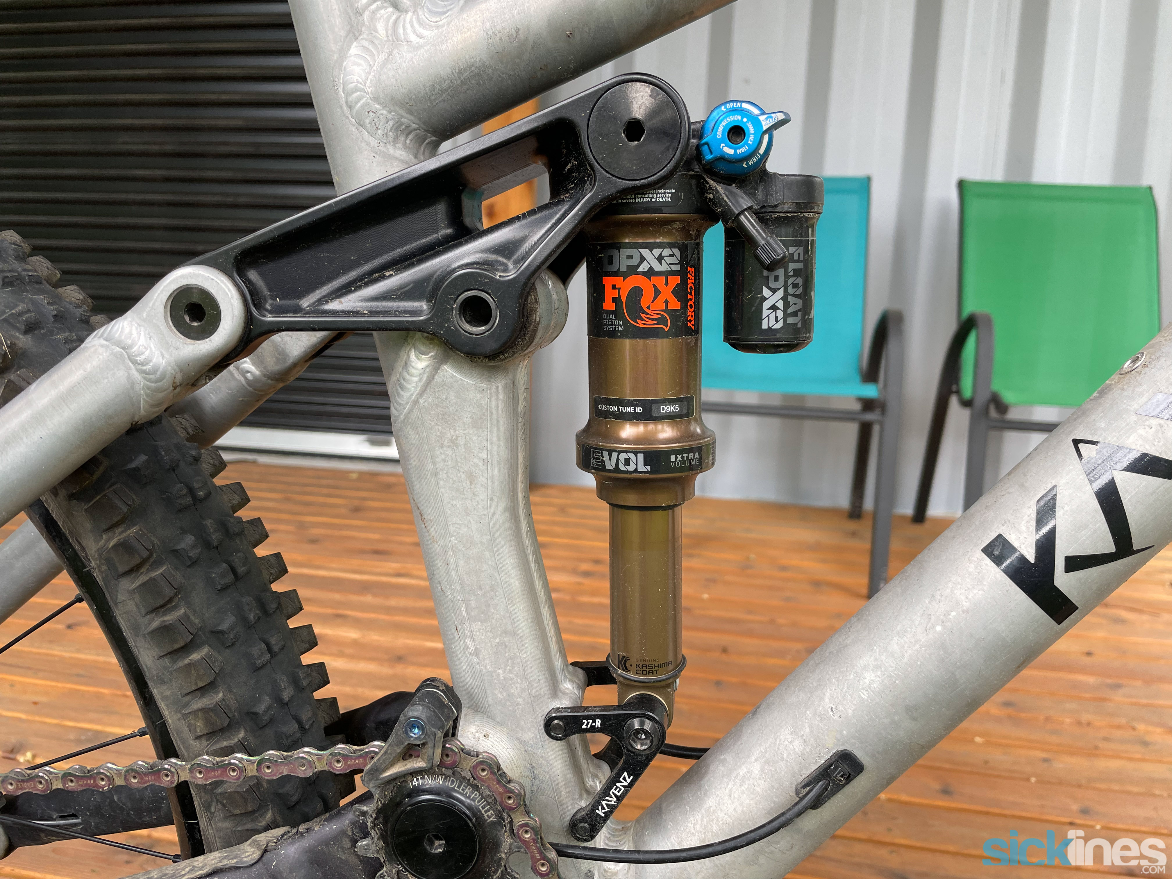

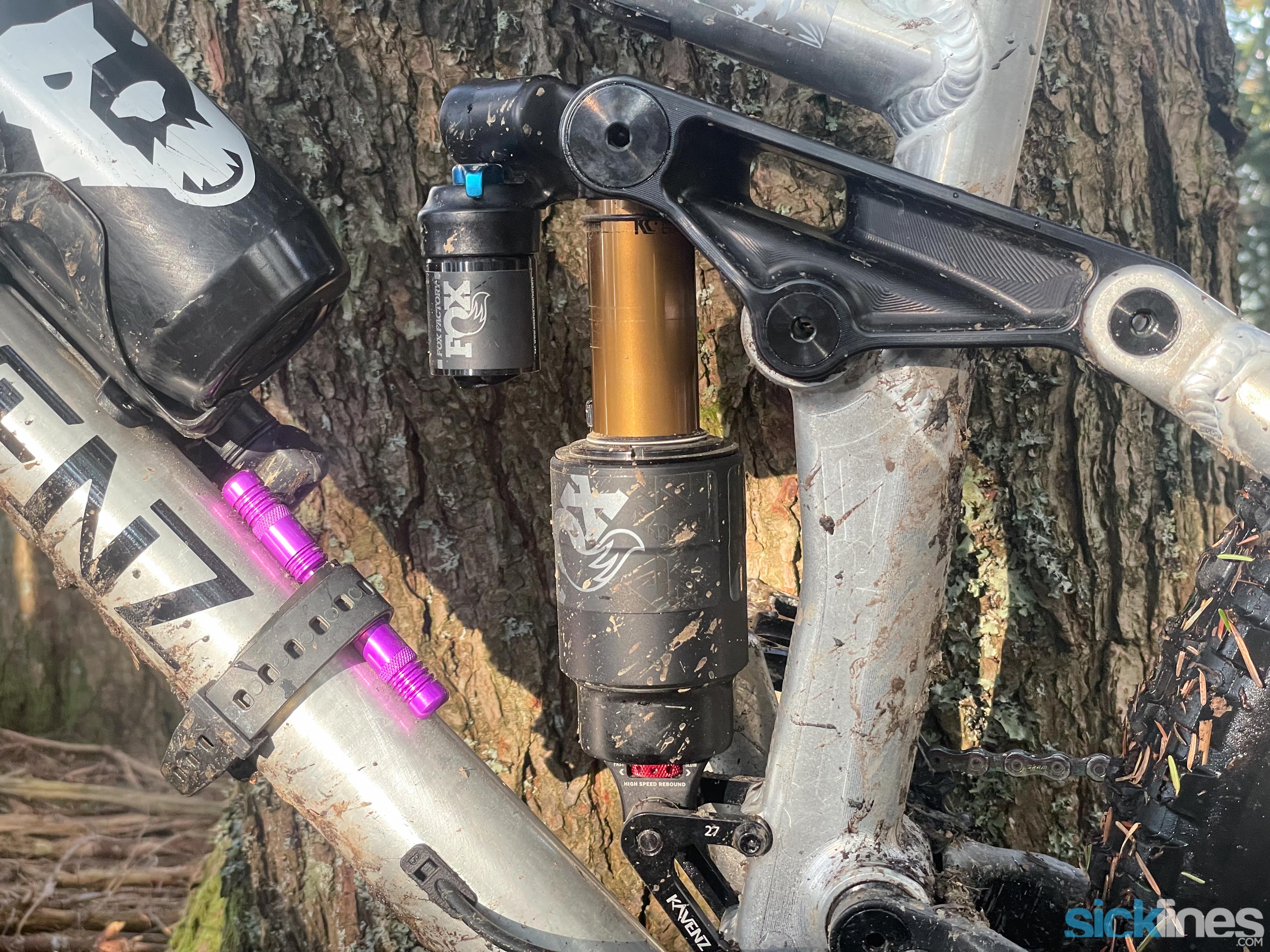

As mentioned previously, the lower shock mount (pictured on left) is all that separates the 29’er version from the MX version of the VHP16. During the test, I rode both configurations and can attest that swapping is a matter of 3 bolts and a couple minutes. You’ll spend as much time swapping out your rear wheel as reconfiguring the frame. In the image above on the right you can see the routing for the rear brake line. Cable routing from the front triangle into the chainstay is one area that I see a lot of new manufacturers struggling and Kavenz did a great job here.

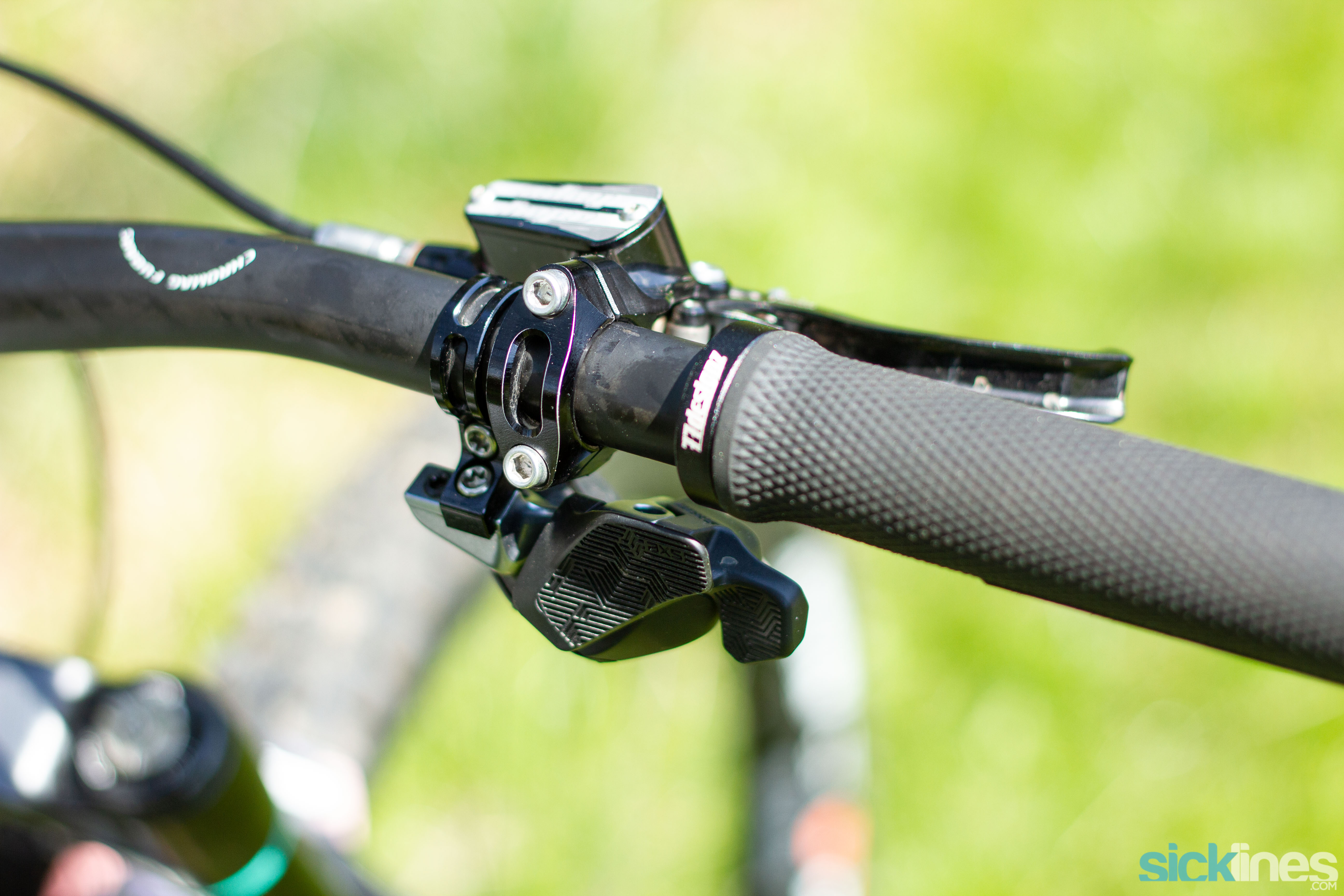

This was my first long-term review incorporating AXS shifting. I’d ridden it casually a few times prior but never consistently or at a pace nearing my limit. Consistent with my first impressions, adapting while riding at a relaxed pace was easy. As the pace quickened, I found the shifter pretty tricky to position for a natural feel and I also struggled with unintentional shifts. After a few months, the paddles now feel intuitive but it did take me a while to adapt. Shifting performance from the derailleur is a little better than a conventional setup but not dramatically. I’ve run a battery for up to about 5 rides and haven’t seen the low battery indicator yet. Overall, it’s a novel setup that I don’t have any real problems with it except that it’s considerably more expensive than a cabled setup for marginal performance benefit. Rounding out the cockpit, I’m running Chromag Cutlass bars at 785 mm, a Ranger V2 stem at 31mm, and 77designs grips.

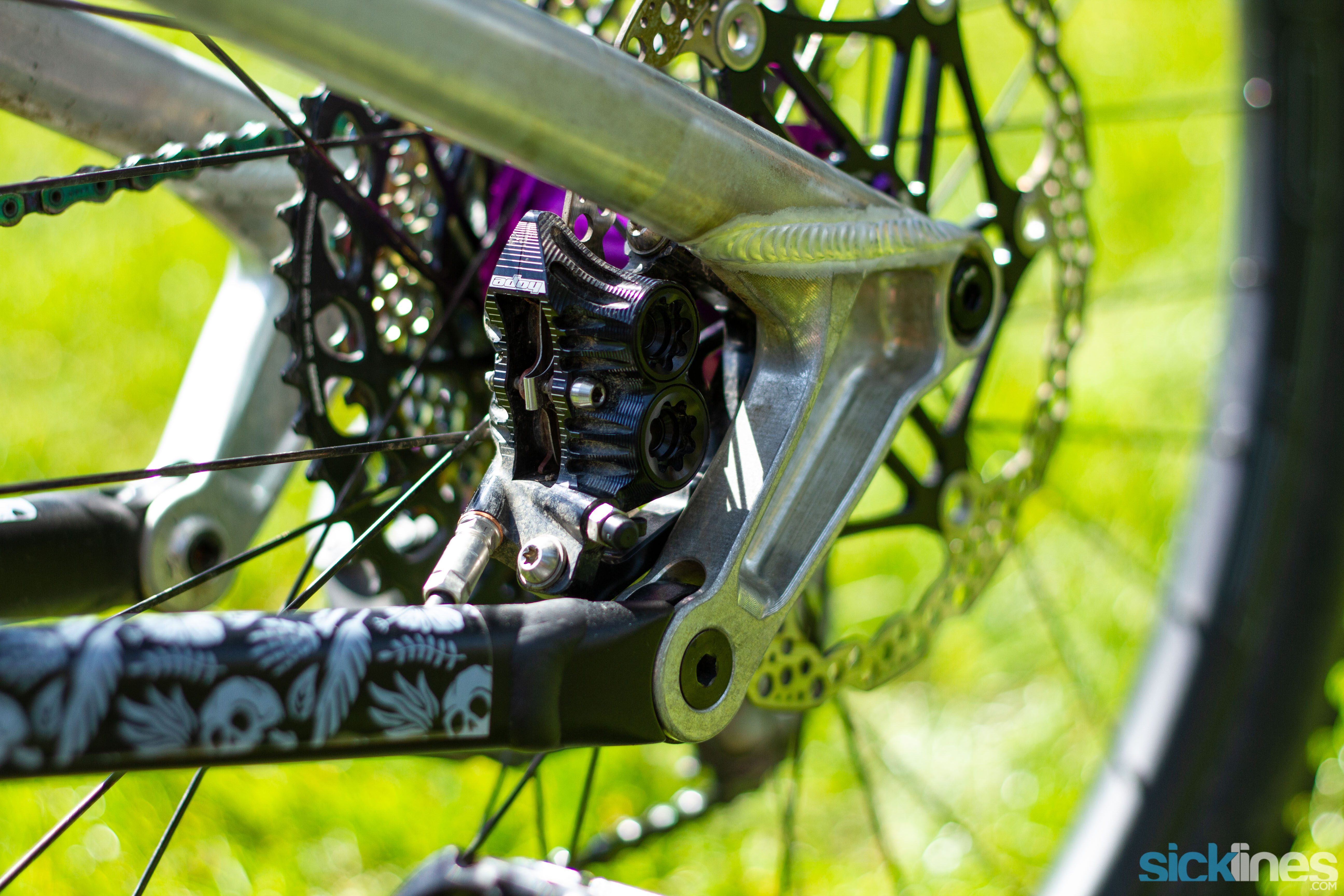

Another interesting feature of the VHP16 is that the rear brake caliper is mounted inside the chainstay / seat stay junction. A special adapter for 203 mm rotors is supplied with the frame and that diameter is your only option. The original test bike from Kavenz was setup with Magura MT7’s which perfectly mated with this design. The Hope V4 caliper gave me a little trouble as the brake line rubbed against the entry port in the chainstay and failed. I raised this issue with Kavenz and they quickly identified a solution and manufactured an updated chainstay. It’s rare that I ride any bike and don’t find some weird issue. It’s outstanding that Kavenz is able to move quickly to address and resolve problems. I want to clearly note that Kavenz documents which brake calipers are known to have issues with cable routing in their FAQ which I chose to ignore. Keep an eye on the site for updates as the new chainstay is tested.

Over on Pamplemousse, one of Squamish’s mellower black trails consisting mainly of lower angle descending, with a couple tricky corners, mellow roller doubles, and one medium-spicy gap I was equally surprised at how fun the VHP16 can be on tamer terrain. At this stage of the test I was still on the original loaner bike with a DPX2 shock. The air shock really livens up the rear end relative to a coil and creates an almost poppy feel, especially with the rebound cranked wide-open. This combo turned out to be a lot of fun for bouncing down flow trails and boosting little airs. To be clear, there are better choices if you prefer to focus on jumping and jibbing but the VHP16 is more fun than you would expect under these conditions.
