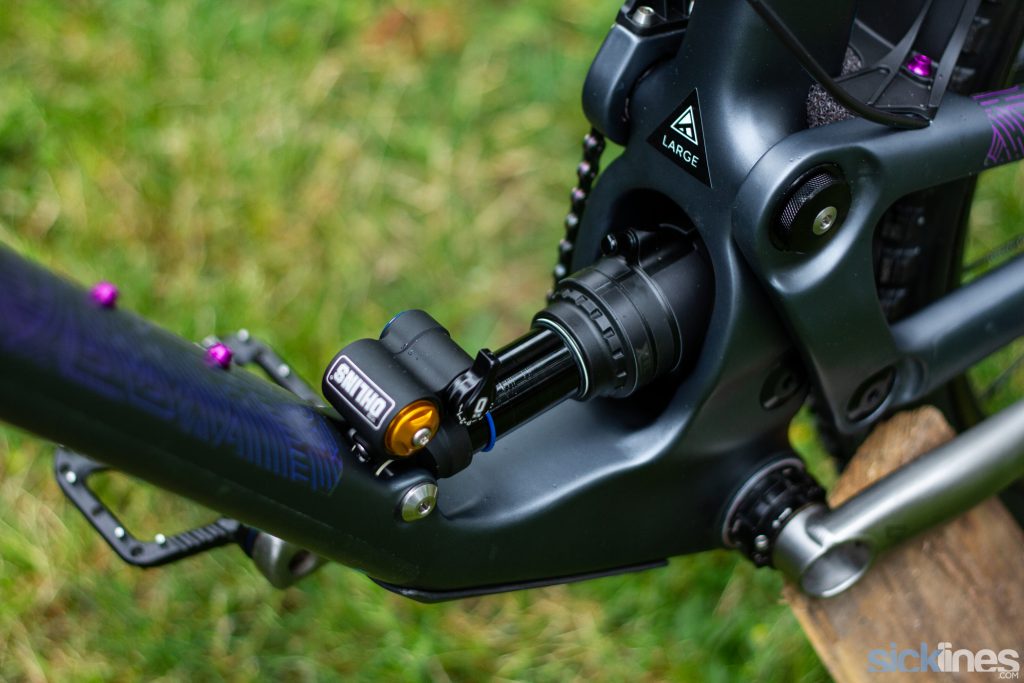

I mulled over my shock choices with the folks at Forbidden and landed on the Ohlins TTX2 Air to best match my style of riding. The TTX2 Air is a twin tube damper designed for aggressive trail and enduro riding in mind. Compared to something like a Fox X2, there are fewer external adjustments although Forbidden offers 2 different base tunes to cover a wide range of riders. I tend to prefer lightly damped suspension and chose the lighter tune for my 175 lbs and have been very happy. All adjustments on the shock are easy to access including the 3-position high speed compression lever in the event you want to firm things up for a fire road climb. The shock and linkage tuck elegantly into a tunnel where the linkage is mostly contained and well protected from mud and debris. When it’s time to pull the shock or service the linkage it’s all very straight forward with few fiddly bits. A couple Allen keys and a few minutes time and everything disassembles for easy servicing. Forbidden has detailed video and photo documentation posted to their Tech site to take all the guess work out the process.

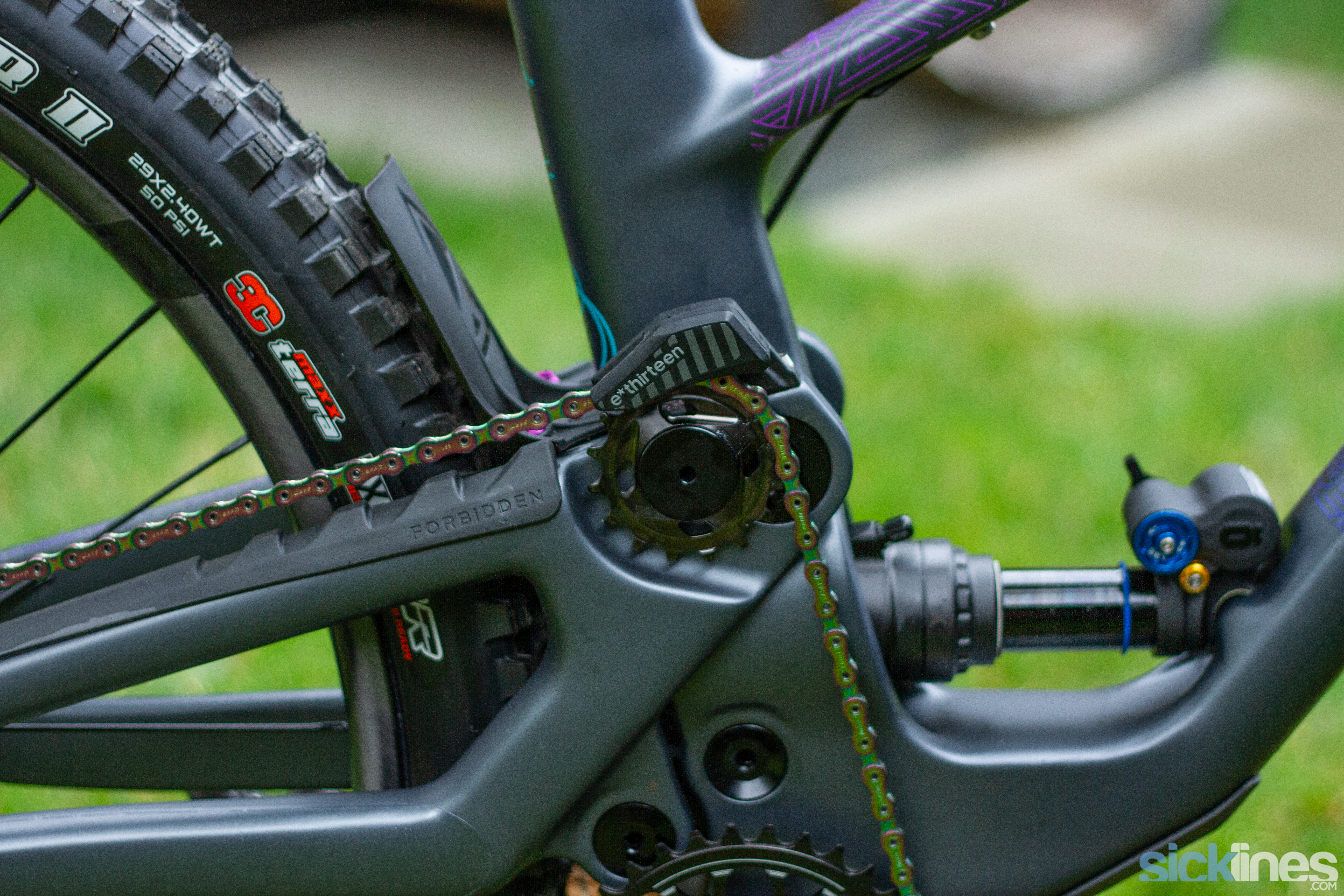

The Druid requires a lot of chain. On the size small, a 126 link chain will suffice whereas the larger sizes require a full chain plus a few extra links. Sharp eyes will notice I’m running the stock upper guide but no lower chain guide in this shot. I tried this setup to see if I could get away with a little less drag but didn’t take long to figure out why Forbidden specs a custom E-Thirteen lower guide as stock. I not only lost my chain without it, sprinting on rough trail caused the chain to bounce and skip on the front chainring. I want to make it clear that this is not the fault of Forbidden and entirely my own failed experiment. Once I installed the E-Thirteen guide, all of my chain woes were instantly resolved. I’ve now done some really big days with the guide and found the actual drag to be more in my head than any real hinderance. If you’re not convinced, Cascade Components has come up with a guide solution that follows the natural path of the chain to prevent it from jumping without adding any additional drag.
Above right, Forbidden worked with E-Thirteen to create a custom chain guide for the 16 tooth idler pulley. The design provides a fair amount of guidance from the rear but the chain is relatively unmanaged on the front side. This solution worked for me 99% of the time. And then there was that one time my chain popped off… Since I was using the Druid to prepare to race Trans-Madeira, I grabbed their race guide (pictured top, left) which completely encases the chain on the pulley. You give up the tool-free access to the chain with this setup but it 100% guarantees (in my testing) that the chain will not come off. I don’t think that most non-racers need the race guide but I appreciate that Forbidden is committed to solutions for those of us that want to push it at 10/10ths pace. Durability of the lightweight alloy pulley has been pretty good with mine looking less than 1/2 worn after a few months of riding. For those of you that put down big mileage there is a stainless steel version that North Shore Billet produces that should last much longer.

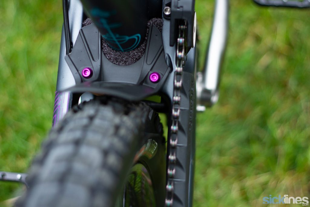

Early owners had trouble with small rocks and other trail debris getting caught between the seat-stay bridge and seat tube mast. No one likes the sound of rocks grinding into carbon. Forbidden responded with an updated rear fender which is both taller and employs Moto-foam to keep that area clear. This update ships with all newer frames and is available for free to anyone with an earlier frame. That’s support done right.
