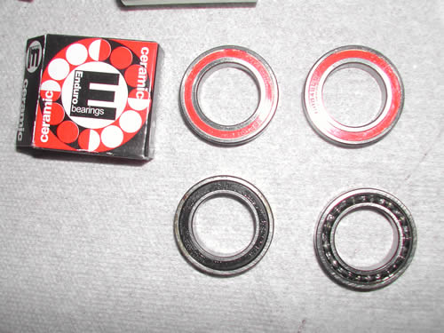

Inspect the bearings inside the main body for wear and smoothness again. There is a bearing on each side. I have replaced my stock bearings with Enduro ceramic hybrid bearings. Why Enduro ceramic hybrid bearings you ask? It increases the time between when I have to re-open the hub back up due to the quality build and of materials Enduro uses in their ceramic hybrid bearings. The Enduro Bearings spin very smooth and are sealed on both sides unlike the stock bearings. (Enduro Bearing model 6804)
, Hadley Rear Hub Service
Click to enlarge
Enduro 6804 Ceramic Bearing comparisons – Click to enlarge

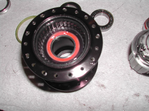

In the event that you need to replace or want to replace your bearings with the better Enduro bearings you then need the park SPA-2 again. Place it on the non drive side and twist off the cap. Make sure to take care not to overtighten this when reinstalling it as not to over preload the bearings.
Click to enlarge
Step 7:
Now that the cap is off, push the inside spacer down a little bit so that you can tap the bearings out. To remove the bearings, you should be able to fit a small screwdriver or punch and tap them out. If you’re replacing the old bearings, its not super important to use a bearing press but if you have access to one use it. The only way to get the bearings in and out is through the non-drive side. The drive side has a lip on it. The non-drive side bearing must come out first!
Click to enlarge
Now you put the new bearings in the freehub body. Make sure to lightly grease them so they go in smoothly. You can use a bearing press, or use a combination of sockets to gently tap the new bearings in. After you’re done with that, reinstall the cap on the non-drive side.
