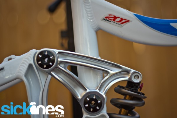

Taking a closer look, the first thing that comes to mind is that this frame is beefy. It’s really hard to convey in photos just how robust everything is on this frame. Monstrous hydro-formed tubing, over-sized pivots, big thick dropouts, every part looks set to survive the apocalypse. Or, at the very least, several years of hard riding. It’s refreshing to see a design that’s not overly heavy but clearly built to last several seasons of hard riding. By the numbers this frame has all the makings of a World Cup contender at 8.15″ (207 mm) of travel, a 13.5″ BB height, 17.25″ chain stays, and a 1.5″ head tube set at 64º. And, while not out to win the weight weenie wars, our medium frame came in at respectable 4215g.

The rocker link pivots on 15 mm axles and the shock mounts with M8 hardware at 22 mm wide at both ends. The 22 mm hardware allows for removing the spring without removing the spacer hardware, another nice touch. The seat tube is interrupted at the upper pivot point but there’s still plenty of room for adjustment over the range that any DH rider will require. For those considering the Pivot as a free ride bike you would likely need a height-adjust post to get full extension for seated pedaling.
