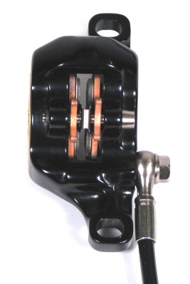

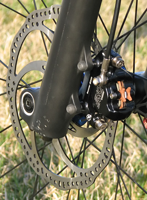

Formula sells a multitude of adapters to fit the ONE to every fork / frame out there. They even have a 7″ Boxxer adapter available. We ran ours on various downhill bikes in an 8″ front and 7″ rear configuration mostly.
, Formula ONE
brake adapters (click to enlarge)
Throughout testing these brakes we found the brakes to be quite reliable and problem free. There wasn’t any annoying rubbing or zinging noises as there was ample clearance between the pads and the rotor. Changing pads was easy as the pads are top loading. However, they do tend to wear out a little quick in our experience but lasted longer than the Bianco’s in comparison. The brakes were also almost completely fade free except for the wost of conditions where they did need some slight extra lever pull.
, Formula ONE
top loading pad detail (click to enlarge)
