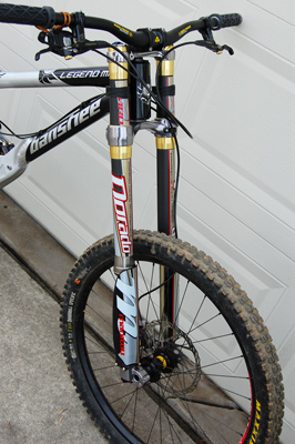

We’ve also strapped a 2009 Manitou Dorado to the Legend as well that we’ve got to try out. You can see a plethora of pictures in our [gallery]. We’ll have a bunch of information on it that we’ll be posting up shortly, so watch the main page for that.
, Project: Banshee Legend MK1
2009 Manitou Dorado (click to enlarge)

As it sits right now, the bottom bracket is 14.1″ and the head angle is at 64.5degrees. The Dorado has a shorter axle to crown than most downhill forks so we’ve also moved the crowns all the way up on the stanchions. The Dorado is essentially completely new for 2009, so don’t be fooled into thinking it’s the same old Dorado of yesterday.
