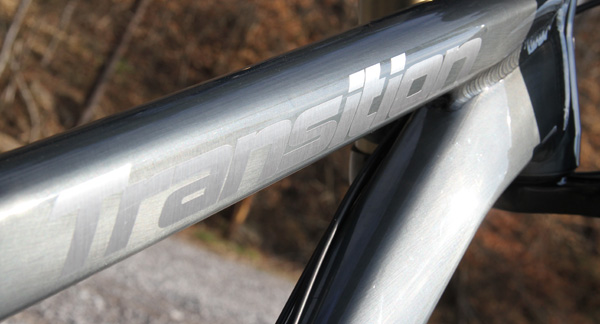

Our TR-450 got back from the paint shop and we opted to go with a black color for our build. It came out looking pretty good and we’re happy with the results.

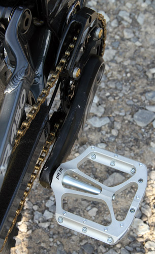

The pedals we used are the Point One Racing Podium pedals. They exude style and have worked quite well for us in the past, so we put these on here again. They offer a nice amount of grip and give a little bit extra ground/rock clearance. We’ve put a tiny washer between the beefy Saint cranks to give the pedals a bit more clearance. We have been running these pedals on rocky courses for some time now and we’ve yet to mess up a single thread on the Point pedals and even the pins have almost all held perfectly straight. Oh yea, and they’re pretty light too at ~368g.

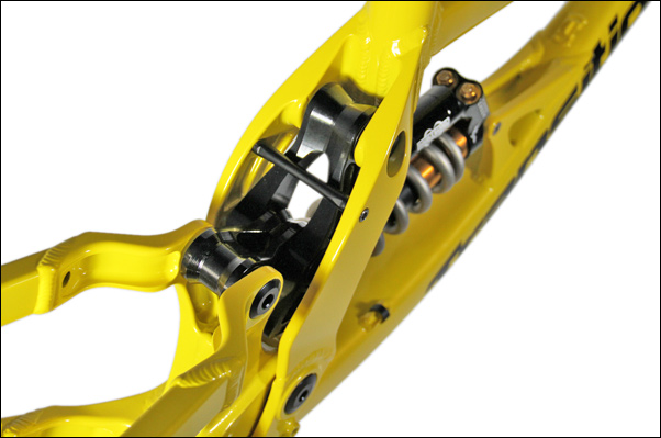

In the back we’ve got a Cane Creek Double Barrel shock. The shock feels quite at home on the TR450 and setting it up was a breeze. The TR450 has a fairly long wheelbase compared to other DH bikes and it feels quite planted on rough and fast terrain. At 180lbs we have a 400lb spring on there currently but plan on trying it out with a 450lb spring as well on the next outing. It has yet to bottom harshly but we’re looking to setup the TR450 to ride a little higher in the travel to see if that improves the ride. So far this bike has a very nice predictable feel to it with the Double Barrel. It has a nice progression to it that lets its take big hits well, but remains lively to tackle the quick maneuvers and everything else in between. The Double Barrel saw some revisions about a year ago and the adjustment range is quite impressive on the shock as it can be setup in a myriad of ways to suit just about any bike and rider tastes.

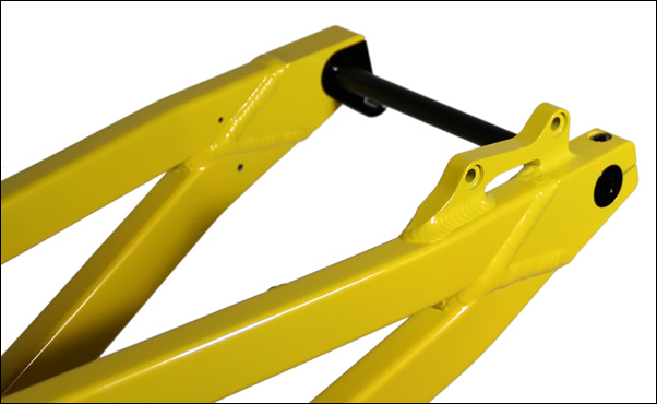

Transition opted to go with an 83mm BB shell and a 150mm rear end on the TR450 and they’ve created a nice solid setup. The back end is firm and quite stiff so when you push into the frame it has a solid feel to it. Transition has done their 150mm rear axle a bit custom. There is a nut on the driveside that slips into the frame. A more captive nut (or something that locks it in place) would’ve been a nice option here and the pinch bolt on the non-drive side could clamp down a bit more in our opinion on the axle.

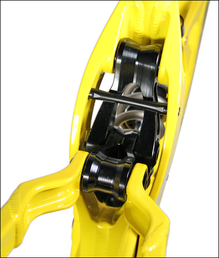

The Transition TR450 offers adjustable geometry though their single pivot linkage actuated system. The frame comes with two sets of geometry chips that convert the TR-450 between three different geometry settings.
geometry chips (click to enlarge)
The frame ships with the frame with the middle position geometry adapters (63.5º HA, 14″ BB)
stock factory chip setting (click to enlarge)
The offset adapters install in the linkage to convert the frame to give a slacker head angle (63º), a lower bb(13.75″), and a longer wheelbase, or reverse the adapters to give the bike a steeper head angle (64º), a higher bb(14.25″), and a shorter wheelbase.
The frame rotates on 2 massive bearings (6904). Bearing life should be pretty much maintenance free given the massive bearings in our experience but all the bearings used on the bike are easy to source should you need to buy them.
main pivot bearing (click to enlarge)
The rear axle is specific to the TR450 and comes included. The axle seems thoughtfully designed as there is a hex shaped nut that fits into the frame. It is nice to be able to just tighten the axle with an allen wrench without needing an additional wrench to hold the nut. The axle nut itself isn’t locked into the frame like a few other bikes we’ve used (V10, Makulu, etc) but the keyed design holds the bolt securely. The hanger is replaceable and easy to swap out.

The shock is positioned low in the frame and the suspension is designed to ramp up evenly through the travel to give the bike a supple top stroke and good bottom out control without excessive sag or mid stroke wallow. Transition did this to give a consistent progressive suspension feel that is predictable and give the TR450 a lot of tunability.
